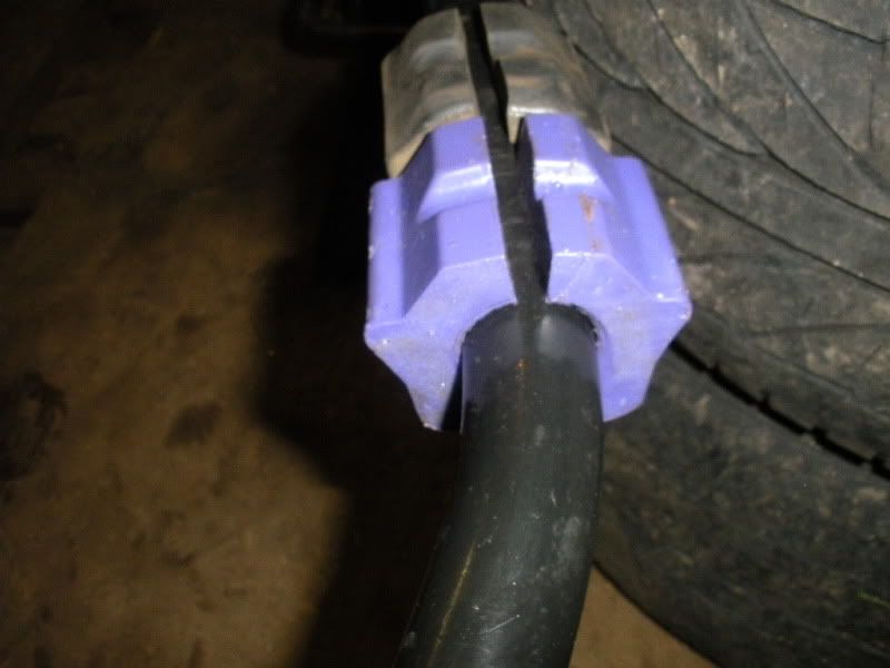

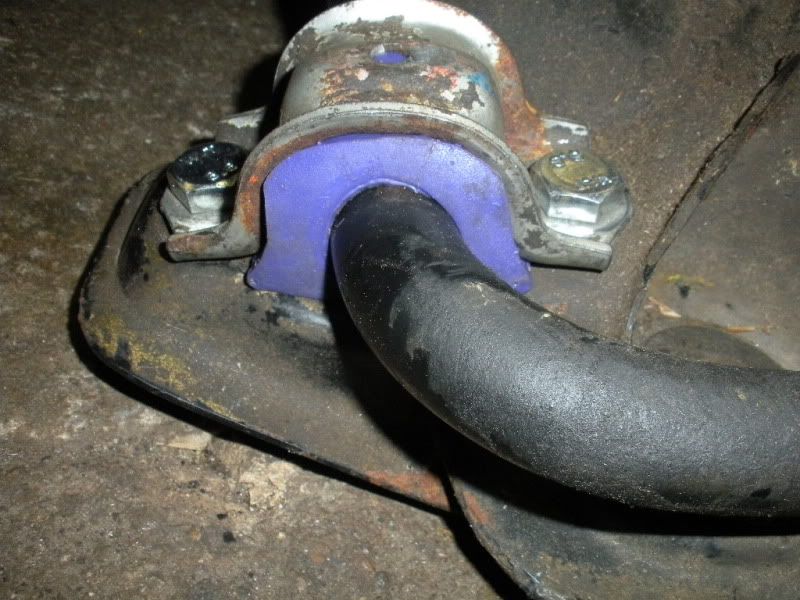

I recently acquired a set of powerflex 26mm swaybar bushings for my 200 20v. Has anybody ever fitted them before? They are shaped like the 28mm bushings and I think they would fit better with the 28mm clamp brackets but did mange to get them clamped down with the26mm bracket.If anybody has pics of them fitted or a link to thread about them I'd appreciate it thanks Austin.

Looks good,i mounted them too with the 26mm clamps.Tight is good.

Yes they've been on the car for some time now without any issues.

can you tell me the part number from Powerflex? Because i can't find any anti roll bar bushes for the 200 Typ 44, just two versions in 25mm und 28mm for the V8
I want to mount all Poweflex bushes on my 200 20v including these

They are the 25mm V8 bushings PFF3-403-25
