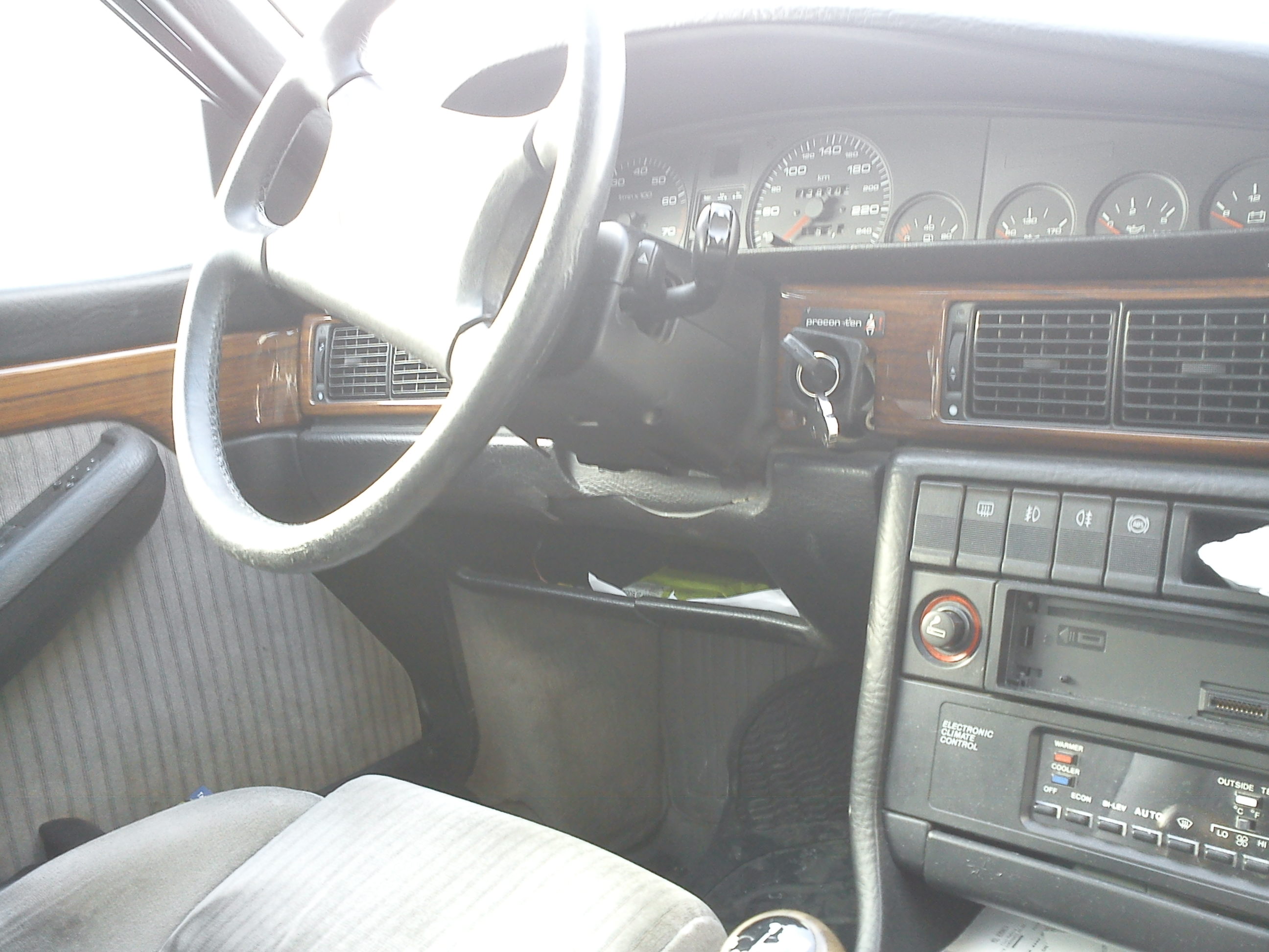

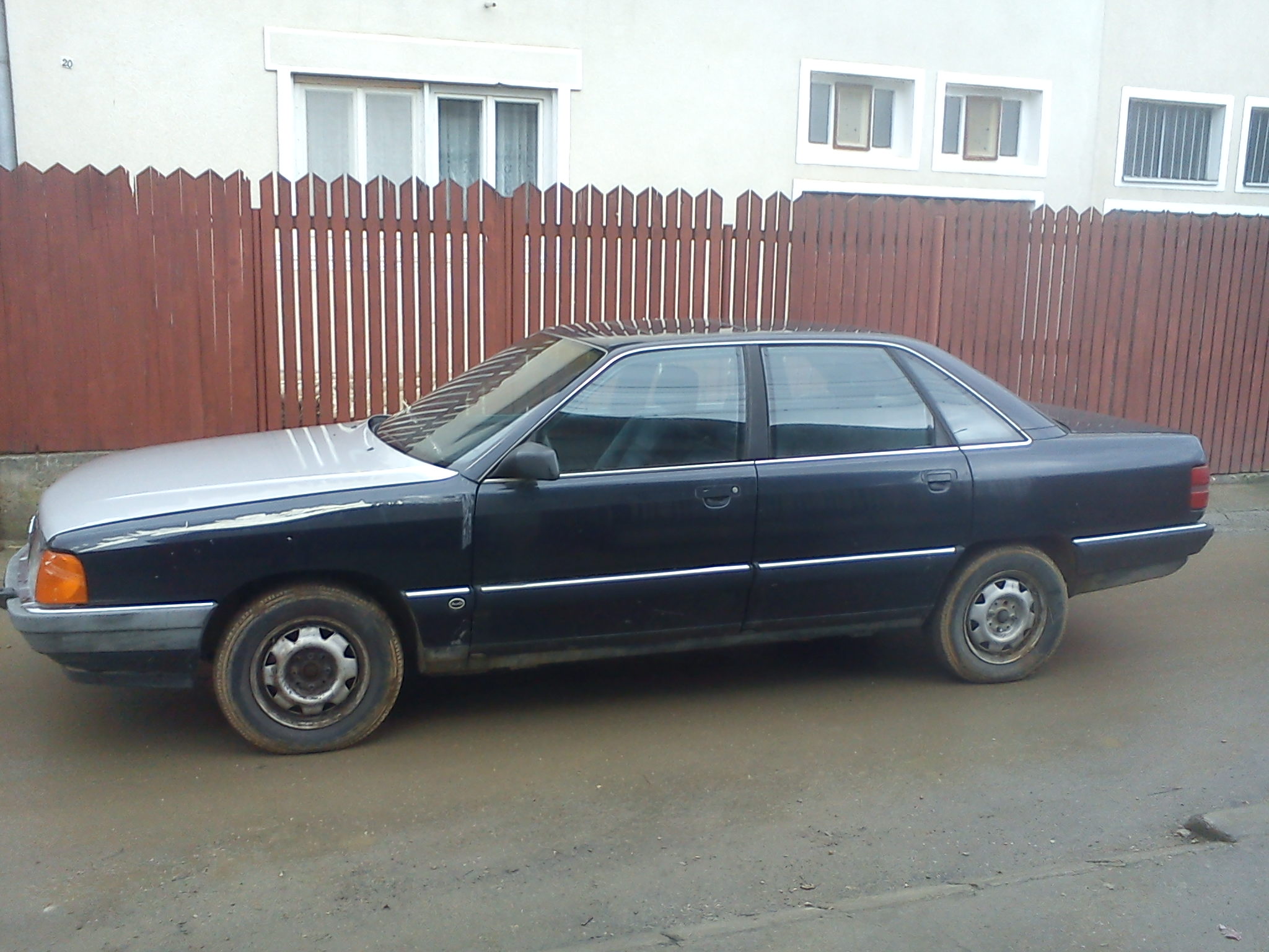

Hi everyone,
I am a huge Typ44 fan. I have a 1990 audi 100 turbo quattro(MC2 engine) , but before Christmas i had a pretty serious accident. An idiot was speeding in town and and entered head-on in my car(more precisely we colided on the driver's side/half...almost exactly like in the EURONCAP tests). I had around 30km/h(the gearbox is still stuck in 2nd gear, the clutch pedal broke during impact...so i hope the gearbox is not busted), but he had enough speed to total both cars. I had my seatbelt on and i walked away only with a pain in my right hand's wrist.
I have the possibility to buy a really cheap 1990 audi 100 NF FWD. Assuming that the gearbox and the drive shafts from my car are ok, how hard is it to convert the new car from FWD to quattro? Are the rear axle and gearbox a bolt-on swap or the body of an AWD car is different from FWD's one? Or is it even possible to do this? Oh and i want to keep the NF engine on the new car, would this engine fit the gearbox from the MC engine? At the moment is more of a curiosity but i would like such a project for the summer.
Thank you.
And sorry for my crappy english :).

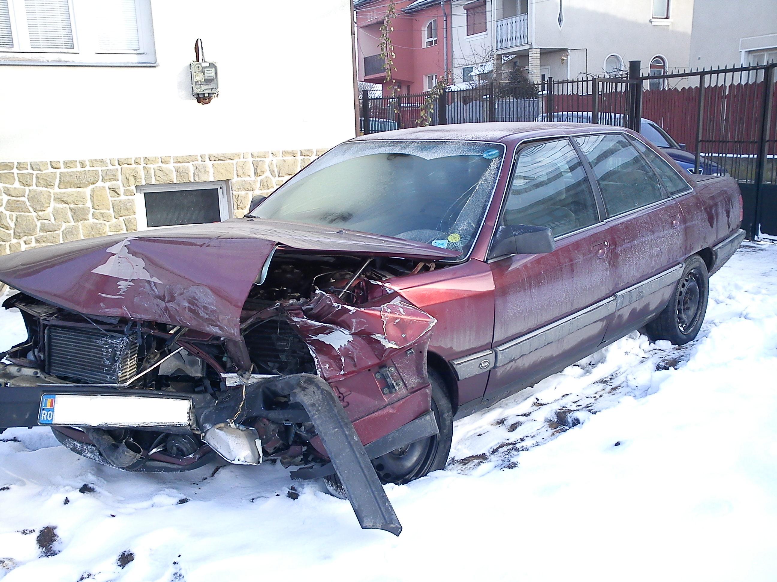

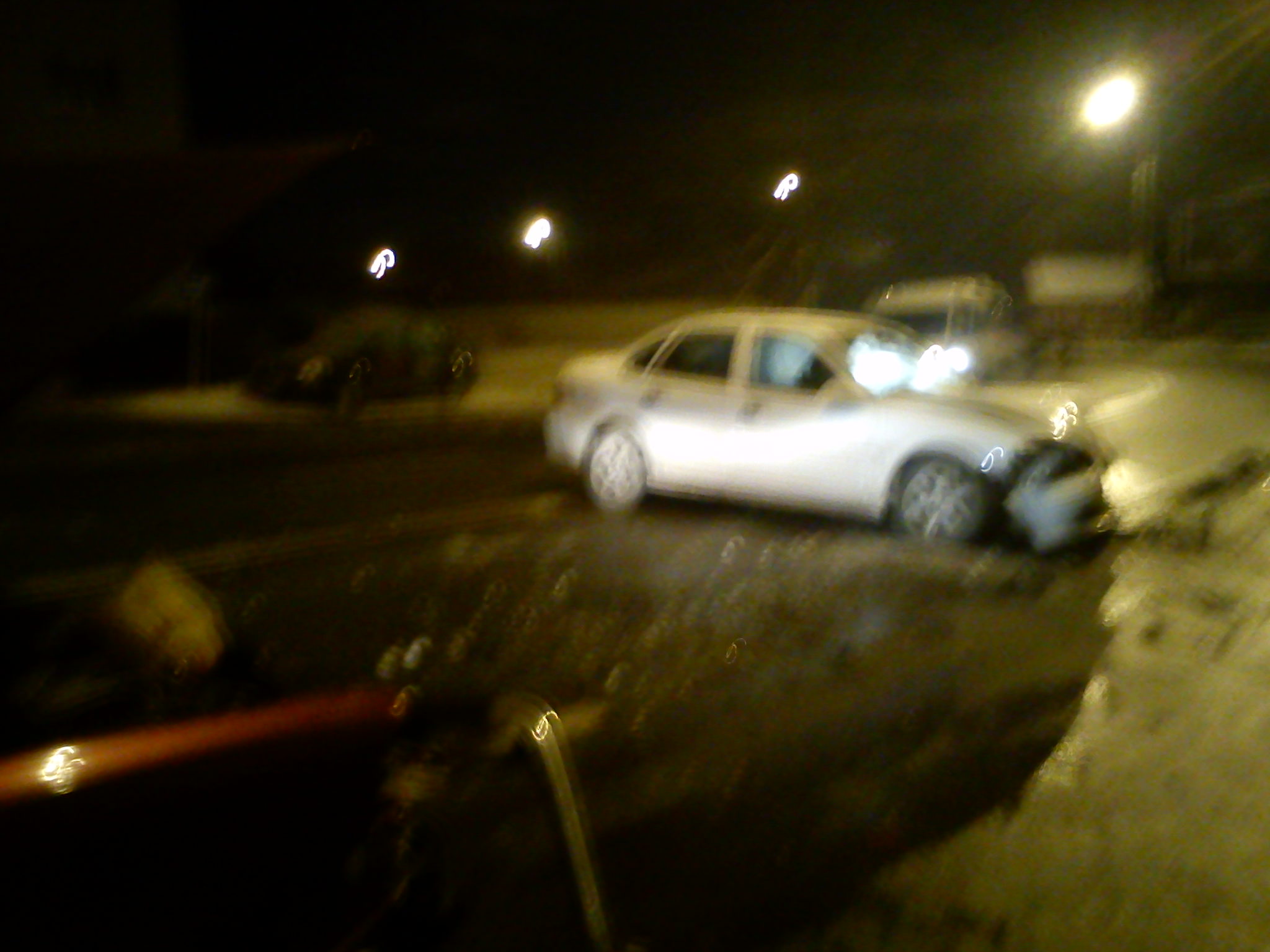

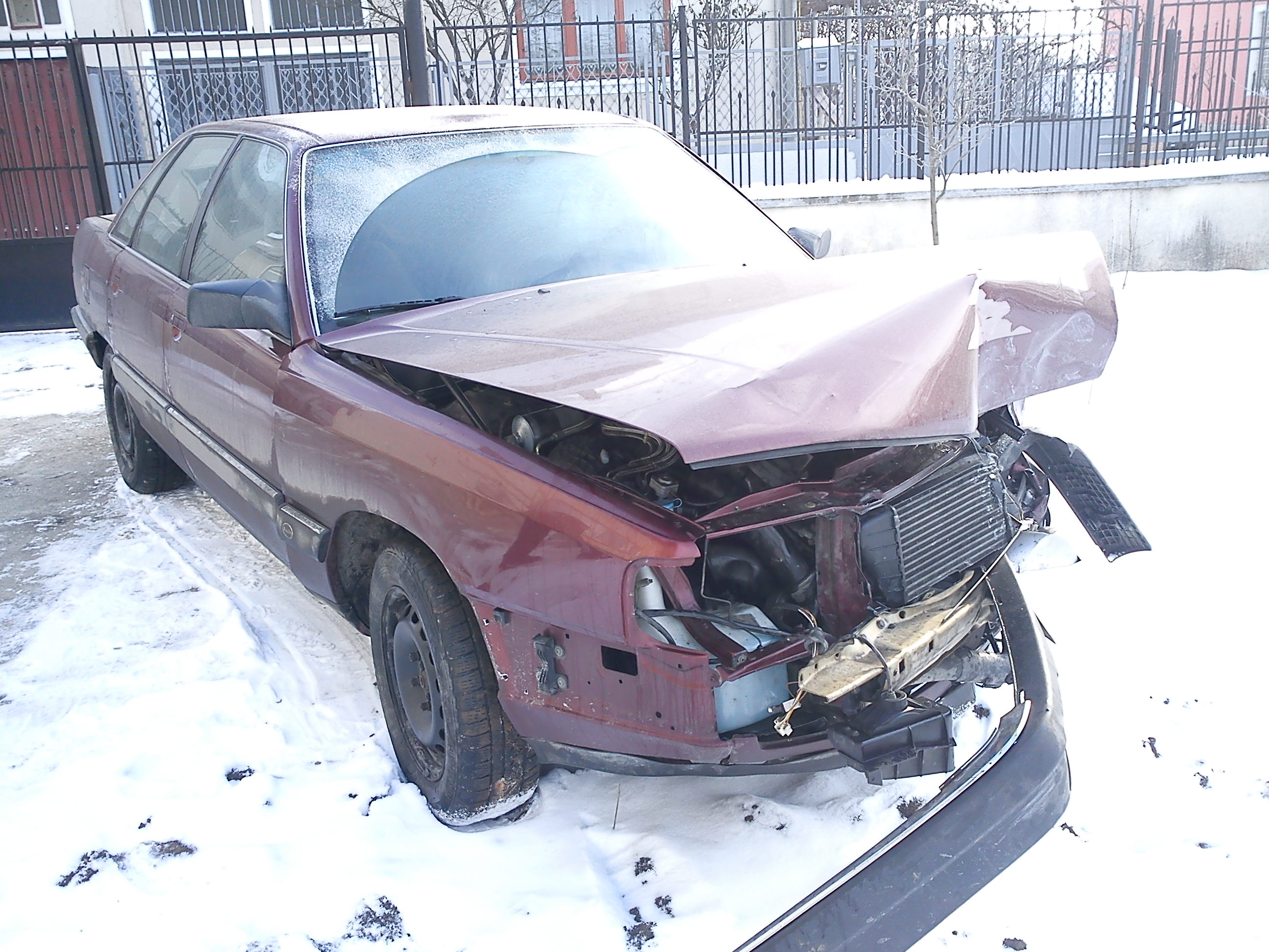

Here are some pics of the car crashed:
The front driver's side pillar is bent, the clutch pedal broke, the acceleration pedal hits the central tunel, the steering column moved upwards a bit, the gearbox lever moved from its original position, procon-ten worked a bit even if the engine and gearbox didn't moved significally backwards(both seatbelts are now locked). In the engine bay everything that's right of the engine is busted. The other car was an opel vectra from 2001, his roof collapsed too, not as much as mine...but his injuries were more severe(back, chest and neck pains), he didn't remembered if he had his seatbelt on but he thinks he had it on and the airbags deployment was very violent because he had the seat moved close to steering wheel.
here's a blurry pic from the accident scene:
mcquattro

Beitragvon turbaxel » 07.01.2011, 16:47
Hi mcquattro,
now I'm really glad and really sorry for you.
Glad, because the accident was quite a hefty one. Glad you've made it without to much injury. The defomed A-pilar / roof is pretty scary. Is the procon-ten steering wheel actually closer the dashboard now?
Sorry, because the car (especially the interior) looked almost new. Very impressive. At least, you could move the complete stuff to the new car.
If I'd be you, I'd try to take a close look at the FWD one you mentioned. If it's ok, then just use it as a temporary solution.

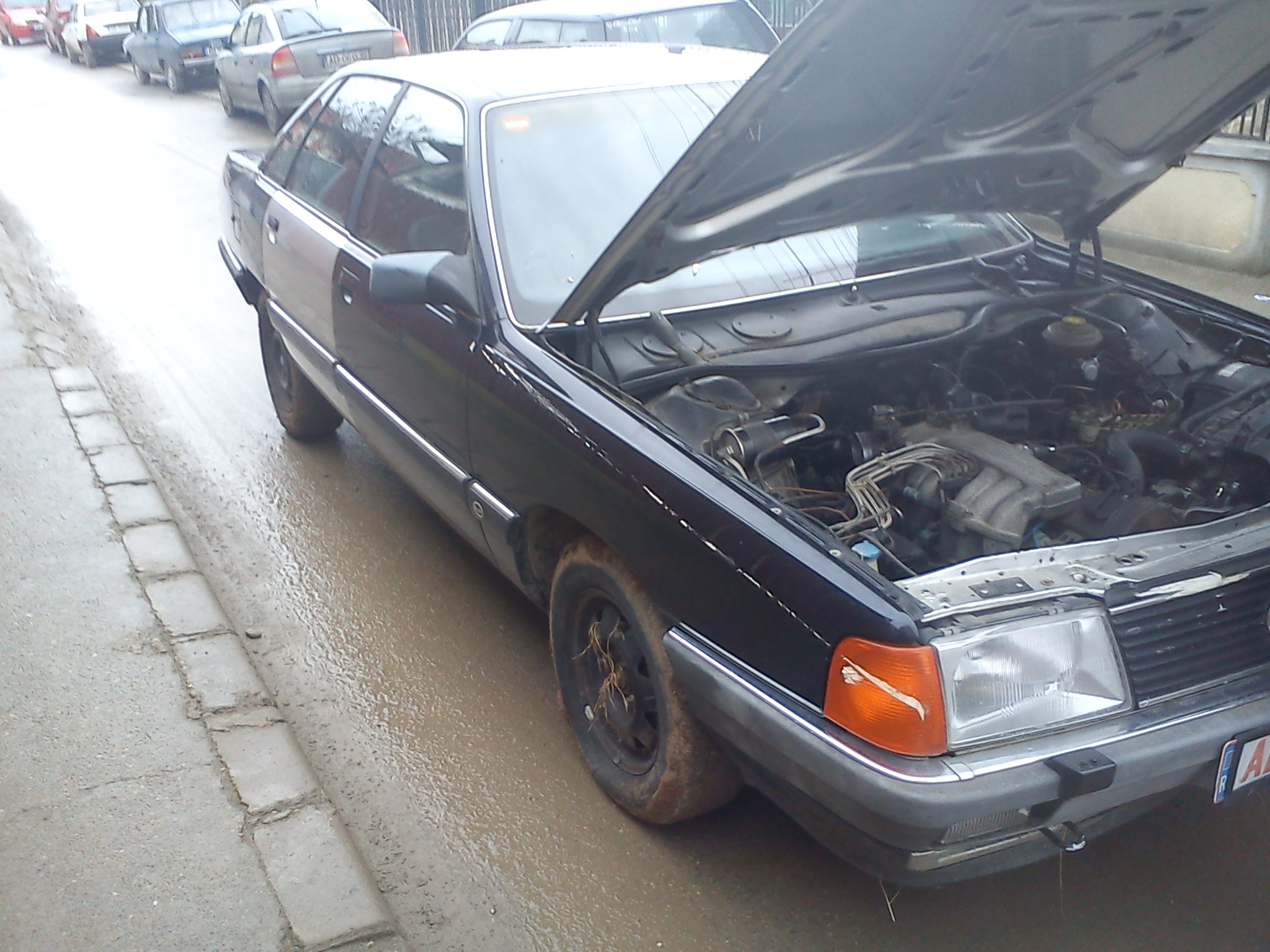

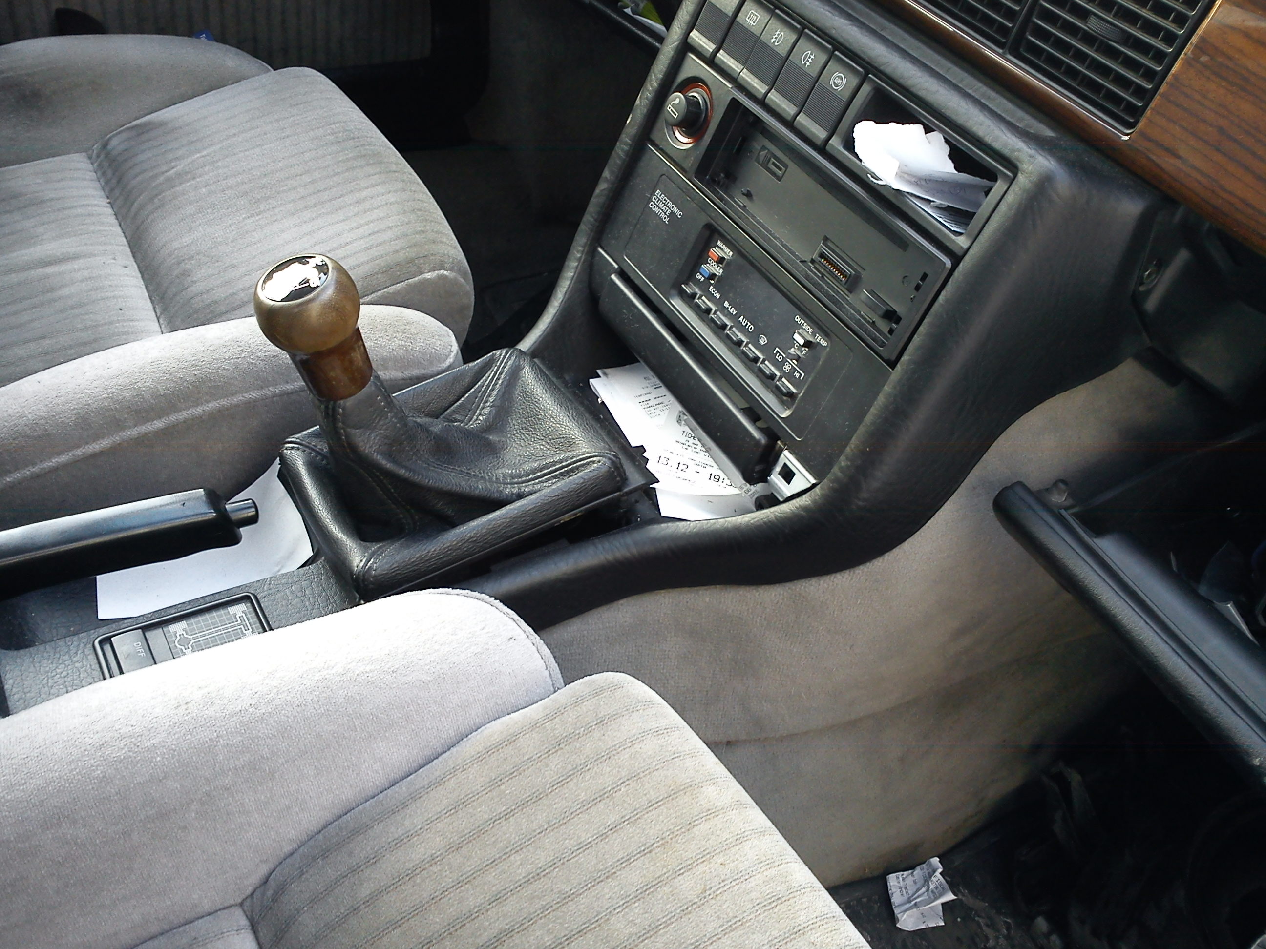

Last week-end i brought the new car home. The car started yesterday, but it would die on idle so it needs a bit of adjusting. After the engine will be done(it will also get new oil, new belts, new filters), the braking system needs to be inspected...after that most of the problems would be only cosmetic ones, mostly on the exterior, the overall paint is in a very bad shape, but the body is very straight(no dents). The interior is in a very good condition(even if i'm not a big fan of the color), excepting the headliner which is loose(any tips on this?). In the end i think it will be a nice looking 100, just needs a bit of work :D . And i convinced myself that the FWD to AWD conversion is not only a bolt-on swap :( .
After a vacuum the interior looked a lot better, also the leather around the gear leaver is already changed.
Exterior after a wash:

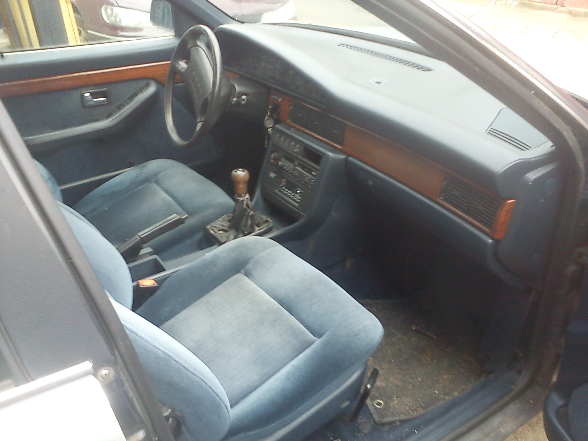

mcquattro hat geschrieben:I could swap them but the Bord Computers are a bit different: on the TQ it displayed the turbo boost, on the FWD it displays the instant fuel consumption.
Pardon me. Maybe I misunderstood you ;)
But, have you ever tried to use the Bord Computer switch on the very end of the right control lever?
It's visible in your own interior image above. If you look close enough, you'll even see the white up/down arrows.
With it, you'd ought to switch the Bord Computer's output between Turbo boost, fuel consumption, range, ..., ...,

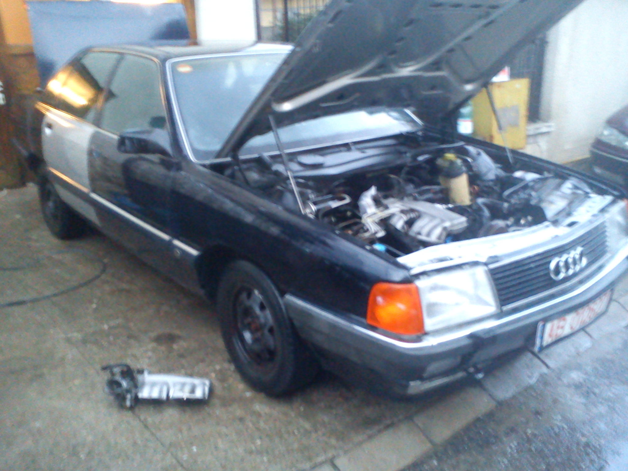

A little update:-D. I had a problem with the engine start up(it was starting very difficult), but now the engine starts and runs perfectly. I love the sound of the engine on full throtle :}} ... i think that it sounds a lot better than my old turbo.
But I have another problem. Any ideea why I feel the ABS engaging, during very light braking, right before the car comes to a complete stop? At higher speed the ABS is working normaly and it engages only under hard braking. Is it some speed senzor? I guess that the ABS main unit from the quattro isn't compatible with the one from the FWD(they have different codes), to try to swap them and see if the problems disapears.
Thank you!
mcquattro
Re: Converting a 1990 audi 100 (NF engine) from FWD to AWD
Beitragvon turbaxel » 26.01.2011, 21:33
you`re right. The non-turbo fivebanger isn`t damped by the turbo, so it`s sound is much, much better ;)
You can even remove a short part of the intake manifold, wich will blow you away. It`s pretty hard to describe, but may be you`ll find it ;)
The ABS problem. I`d seriously check all 4 ABS sensors, all 4 ABS cables (especially their connectors) and the according ABS gears which can easyly be dirty or damaged. I once had the same failure while having a dirty abs gear on such a car.
Here you can see the ABS Sensor and the underlying gear (right on the inside edge of the brake disk):
The ABS on FWD/AWD will proably be different, I`m sorry. ;)
